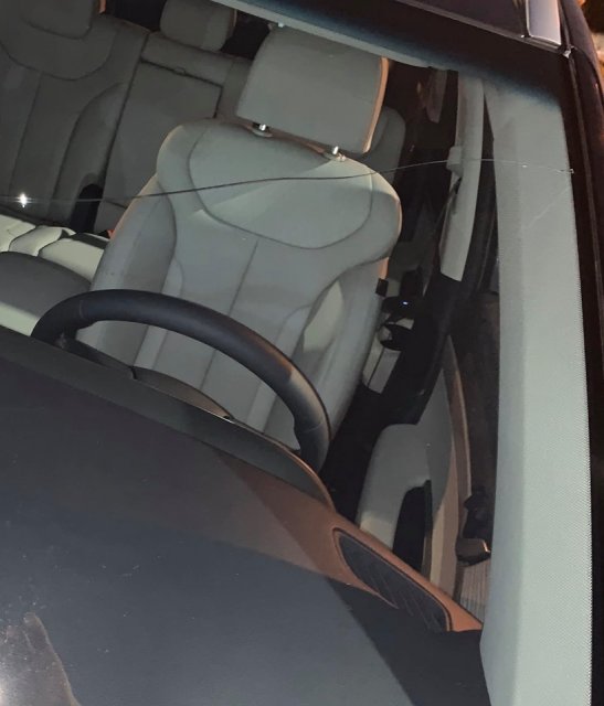

I have a similar issue with my 2023 Palisade. The hairline crack starts at the top of the windshield, no chipping, no nothing, just out of the blue. Now is pretty much more than 2 feet long. Safelite can install a new one for like a $1K (they do calibration also). I have a few cars so unfortunately my glass deductible is high. Because I read a bunch of horror stories online on cracked windshield I decided to write Hyundai to see if they can cover for a new one. I don't feel optimistic about it but I had to try. Anyone have experience with Hyundai Corporate and warranty on windshield? TIA
